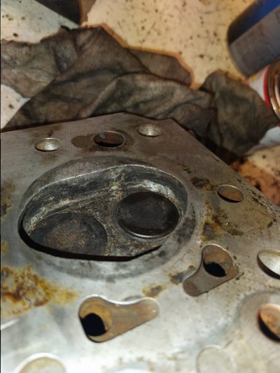

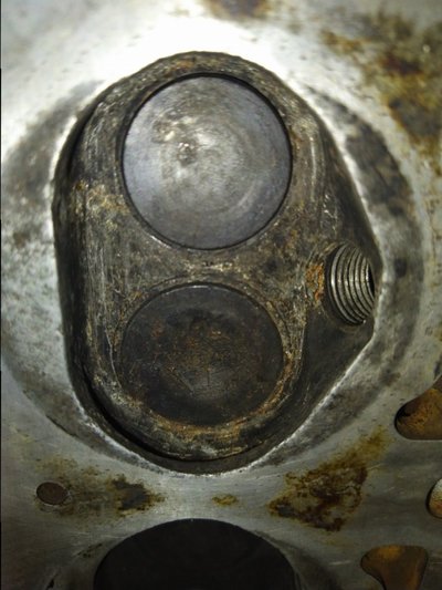

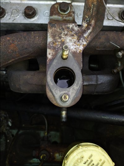

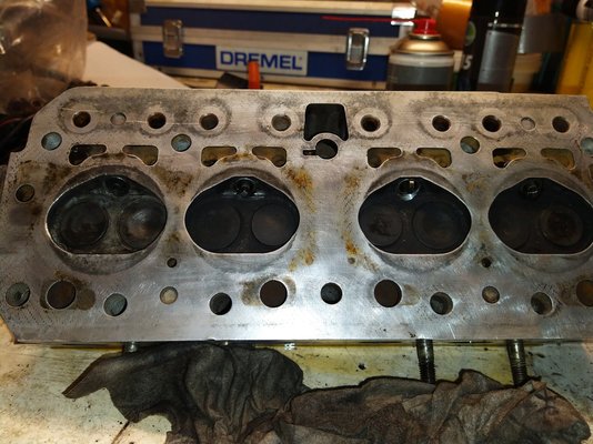

I noticed a lot of water drops splatering out of the exhaust and out of the vent hose from the head to the carburator. So I lifted the valve head...
This is after way less than a hour running stationairy and ocasionaly revving it a bit. Fiddling whit caburator settings and dizzi timinglight.
I 'm wondering if it's only the head gasket or worse.
I have a complete gasket set allready but i need it running 29 oktober. And have little time. I have to take out the motor to change the complete piston bush gaskets because I lack a car lift. So I hope these are okay.
I fear for the worst but I lack the experience to back it up. ( First Ventoux engine I touched) so thoughts are apriciated!

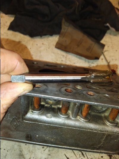

O and later on i pulled the sparkplugs to check if they were wet. The were dry but one crush ring on cilinder 2 sparkplug was not crushed. Turns out there is a bad tread in there. So the head needs some love and care. I can check the valve seats then allso. And maybe this could produce a stutter or backfire in my opinion as well.
