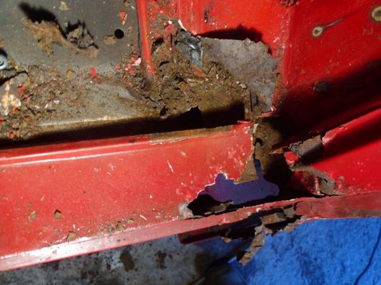

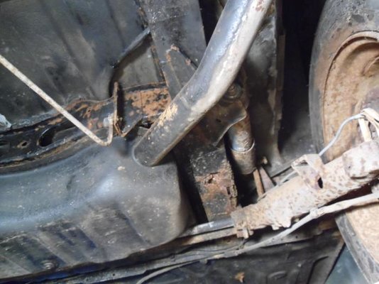

Having recently bought a 1984 renault 4 restoration project I am now finding more and more problems having got it home. The car had been garaged for over 7 years and when looking to buy it I decided to go and look at it first as recommended on the forum. I knew what to check for and was ready. However, on arrival it was impossible to see the car properly as access was a problem. I looked underneath as best I could but only access to rear and back offside. On the day I walked away but overnight thought again about it and decided to take a chance on it and agreed to buy. I dragged the car out of the garden asbestos shed kicking and screaming and after removal of several years of ivy growth.
I now find the chassis rusted to rear shock area and it appears this will be a body off restoration as I fear more problems to be unearthed. This is going to be a huge learning curve for me and I think a welding course is needed. Just a shame the chassis is not made of timber. I am out of my comfort zone so looking for reassurance please.

Regarding the chassis, these should be available new soon, and even if that doesn't happen, good chassis turn up on leboncoin relatively often.
If the body turns out to be too rusty to restore, it may be worth cutting your losses.
You may have bought the car, but you are not committed to restoring it.

Ok it looks bad, but a promise is a promise. Mig welding isn't a black art and it's well within the scope of all of us enthusiasts, so learn a new skill my dear chap. I don't imagine you paid a great deal for the car, so if you can do the metalwork yourself you save on the labour, then if you do have to pay someone to attend to the mechanicals it still won't break the bank. What a great birthday present for your better half, but be prepared for some long evenings out in the garage, but atleast your good lady will know where you are:D Of course you are amongst a good bunch of knowledgable people here, so just ask away. Golden rule, stay positive.
Personally I'd be tempted to leave it for the moment until a new chassis is available. Alternatively I do know of a late GTL, freshly restored that is for sale very soon. Its not mine but PM me if you want more info.
I'd do the same as Lobster suggests, you'll end up spending far far more money getting that car sorted out than by buying a good condition car in the first place.
If you don't have the equipment to do it now it could be costing you an awful lot of time and money, when you could just buy a good one and keep it maintained!
I've been in the same position previously and I've learnt things like buy one good one in the first place, rather than buying twice cheaply.
Well I for one think its a great buy; it looks very much like the car that I've just bought. The rust doesn't look that bad' it's definitely fixable because I've seen far worse on this website.
You're in a position to learn so much more from this experience. The secret is to take your time over the repairs, bit by bit. If it doesn't work out after 2 years you could always buy your wife some jewellery.
Contact Mélun Retropassion NOW and put your name down for a new chassis. It will encourage them and thus marginally increase the chances of their project coming to a successful conclusion.
We are all hanging on the hope that their chassis project succeeds and if it does I think they will be pleasantly surprised by the number of orders. I am down for two and have foolishly committed myself to a third as a result of Malcolm's big clear-out. Looking forward to 2013!
As regards bodywork, get new panels rather than try to repair old ones. They are still available on the Continent.

From the photos it looks like it might be useful for you to know how to weld yourself as welding will be the thing that hikes costs beyond buying a decent car in the first place. www.mig-welding.co.uk started out from here and might be worth a look.
Other than that the rust in the photos looks reasonably typical. It's an A reg car made before decent factory rustproofing that protected the wing and underfloor seams so be sure to seal and rust proof as you go along.
