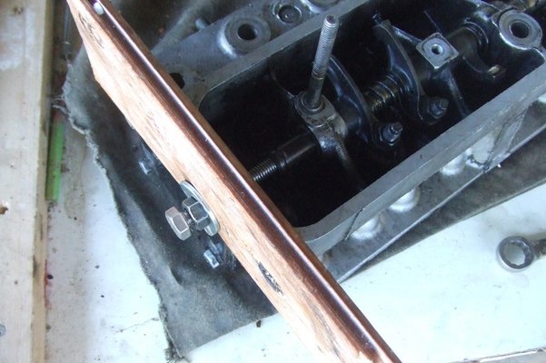

Here is a photo of the removal of the back rocker bar. I screwed a bolt with a nut into the rocker bar and pulled it out by turning the nut

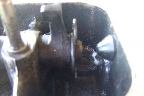

Here is also a photo (blurred) of the grommet lining up perfectly with the end of the rocker shaft
Yes is definitely him! Thanks mojobaby!
