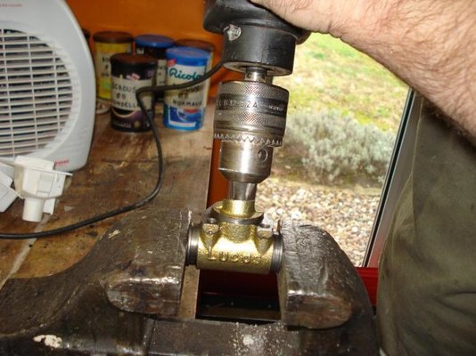

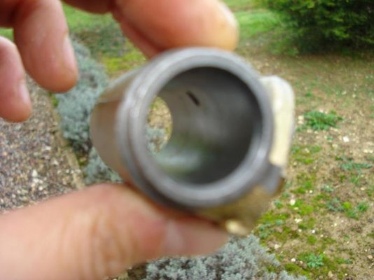

Does you mean "brake" cylinder ??? If so, maybe you have the same problem as I had few months ago, one of my cylinders hadn't the hole inside, Ive never seen something like that before... We had to drill the hole to make the cylinder working well...
