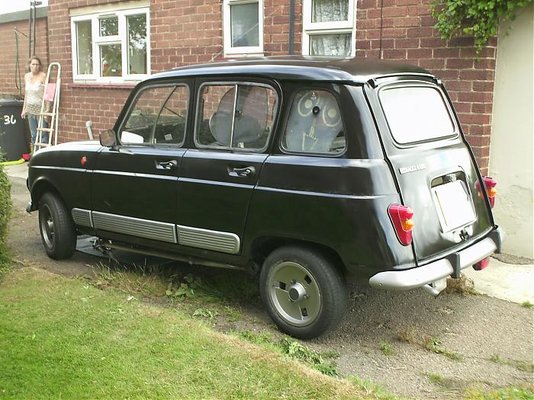

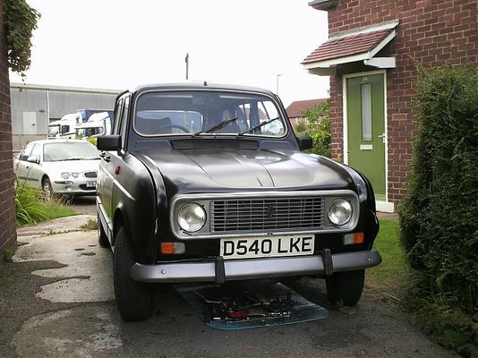

I've fitted the engine with gearbox into the car, only to discover a rather large oil leak from the cam, turns out that the auto gearbox has the bushes and seals for the camshaft attached to it!
Anyone any ideas as to how to fix it? It being a Type 847 R1229 !.4 with the extended auto camshaft.
Also when fitting the distributor driveshaft gear should it be as the 688 engine, ie at 90 degrees to the engine, or as the 810 engine with another 10 degrees?
It's sad because the car looks ok, it just can't go for the want of possibly a bush and an oil seal, (and the correct ignition timing set up!).
