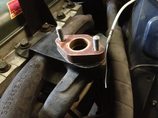

I cannot answer that but guess taking top off to flush out crap would be useful? I have just bought a reco 28IF for an 845 motor and the studs were too long so got some bakelite/ composite stuff to make a spacer, keep the carb a bit cooler, no example exists in manual for this purpose but I figure as long as sealing can't effect performance as such,
