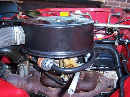

I am currently running the car with Shell Optimax (99 RON) and a a 'FuelCat', its a device placed in the petrol line just befor the carb. The petrol filters through it picking up a lead replacement. The car runs fine on this and there's no hassle with pouring stuff into the tank.

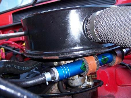

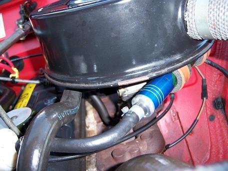

Fuel Cat
Here's some photo's of the fuel cat I fitted.
Seems to be doing it's job and hasn't damaged anything yet!
Regards.
