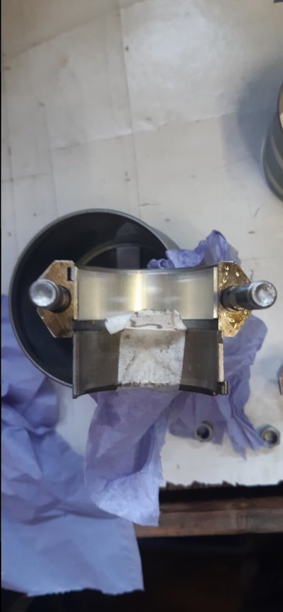

Been trying to rebuild c303's engine in what seems to be an unending battle to get this car back on the road and am getting ready to give up.

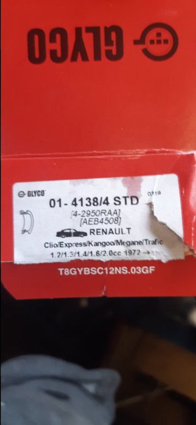

Replacing the shells on the big end and noticed a size differance.
This is an issue correct?

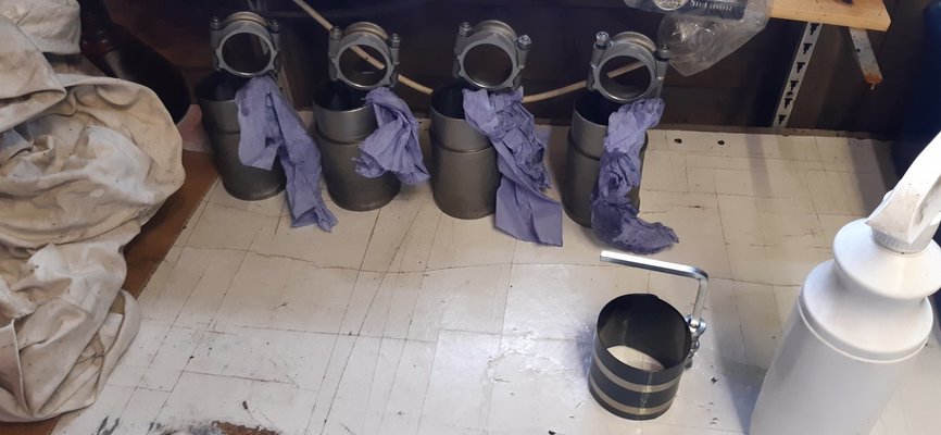

Have a pic of when I thought my day was going alright
These are for newer overhead camshaft engines with narrower connecting rods. Correct part number for the 1108 is 01-4137/4.
