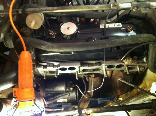

Do you think I need to take the head off and check the valves or look!
The problem starts at the bottom and works up.
Just done a compression test, 4 185psi, 3 185, 2 170 and 1 165.
Had the rocker cover off to check the valve clearances, should be IN 0.15 OUT 0.2, they were 0.9-0.7,0.5-0.25,0.13-0.22 & No 4 was 0.11-0.15.
Changed leads, plugs, dist cap, rotor arm & still it judders badly in 4th below 70kmph but ticks over and runs fast ok. Pipes on carb checked too.
If I pull leads 1 & 2 off together it runs and sound the same, pull 3 or 4 off and it stalls.
Renault 4 GTL 1993 runs ok under load & at reasonable speeds but under no load it judders really bad at 30mph.
