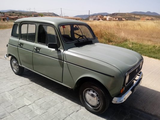

I have purchased what I hope to be a fairly good late example TL. Havent actually seen the vehicle in personyet, but the seller has been a true gent and I am quietly confident. That said I have been advised, and from photos it seems clear, the seats are a bit of a letdown.
Can anyone advise if it is easy to swap front seats with that from a more modern vehicle - a clio for instance. Indeed having had spinal surgery last year I can claim dispensation on medical grounds!

Welcome! Looks like a Spanish car, am I right?
As the seats I saw lots of people installing fairly simply MK1 Twingo ones
How can you tell? I am a novice,. though I was married in a R4 in 1991

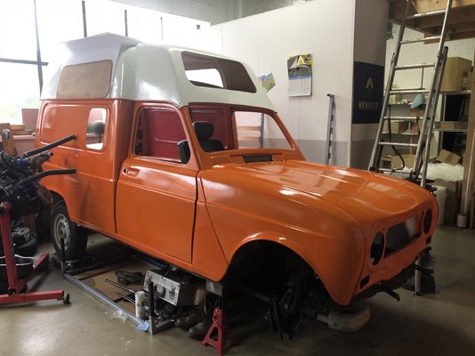

I have a pair of Clio Baccara seats in my F6. Easy swap for my car. Bur for a Berline you need to do some welding and remodeling of the rails To make them fit.
A Berline is the 4 seater version you have.
My F6 is the bigger van version. Sits 2 and a tremendously big trunk.
