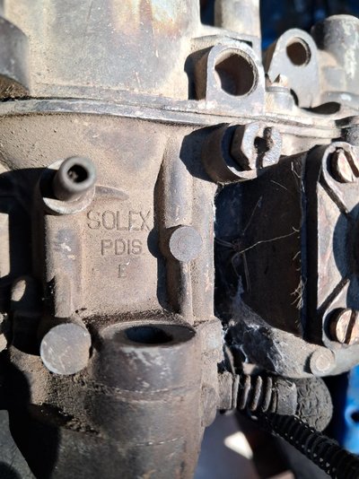

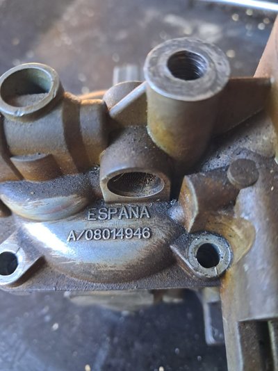

I found the problem! the diaphragm in the carb was completely shot,. So now I have it running and it makes a lovely sound on tickover. That said I still need to address a few things around the carb. It would appear its not the factory spec , and apeears (at least the references I find online) to be from a fiat 127, but I doubt its much different from the rough old PDIS E which I found in a box in the boot.

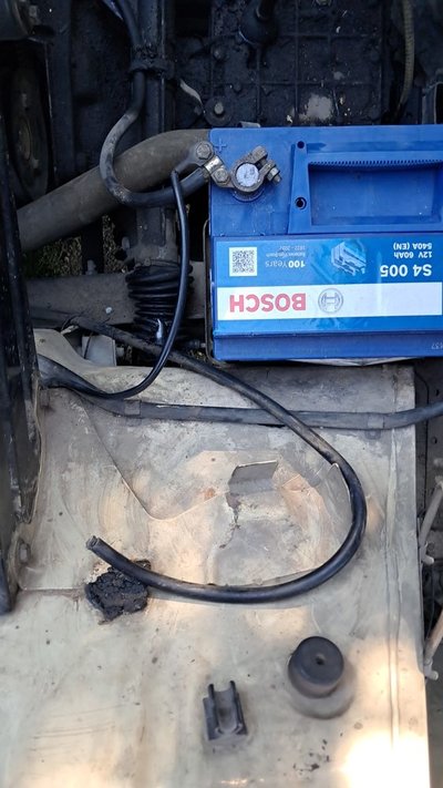

next in order of magnitude, and surely for the MOT I need to replace this burst boot. Not sure how big a job this will be, but it does beg the question - what is missing from the front right section of the engine bay. All I find is a heavy duty earth cable which comes through the bulkhead but has it seems been rudely amputated?!

I have a new air filter and bits and bobs on order. the carb defo needs a new gasket, but weirdly the float does not wish to come off and has the gasket "trapped". I am terrified to break it, but the pin is not for budging. So many different Solex carbs out there - and all differernt! I have a guy locally who will treat rebuild the carb and may also line the tank depending what I find. So far though much cleaner than I would have thought. Any thoughts on unleaded and these engines appreciated?
duh! the jack and handle it dawned on me,..
You can buy complete carb servicing kits, with all the gaskets floats and bits and pieces included, that are not expensive. I got mine from Franzose.
thanks folks. I think I found the problem - the "base plate" sandwiched between minifold and carb was loose, and I am sure it must have been drawing air. Now I just need to get the whole new set up tuned nicely, but running much much better, though needing a little choke for the mo.
