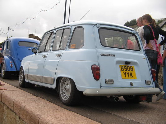

Hi everybody ---- I have had a chance to take in what has been said and I have had the vin number from my car checked by a Renault dealer ---- they say it is a 1990 built car with a 1108 engine so that being the case
1) Would the manifold and carb in my R4 be the same as the one being suggested by Malcolm from an R5 as the manufacture dates cross over or were they different.
2) I must have viewed hundreds of pictures of the R4 by now and it appears that the "Gordini's" seem to sit with a lower stance ---- is the suspension on this version different or has it just been adjusted down.

This stance would be great for what I have in mind ----- not sure how it is achieved yet IMG_4172.jpg
but would love to replicate it
Steve
The Savane was originally 956cc. It shares the same block as the 1108 but has smaller pistons and liners. It was a bargain basement model.
The Gordini engine was not fitted to the R4 as standard so all are conversions. It is fairly easy to lower the suspension by removing the torsion bars and refitting a spline out per inch of lowering. The rear torsion bars tend to be seized in place and tricky and you need to make a tool for the front (see tech tips) Mine is standard height.

2 - R4 ride height seemed to vary a bit anyway, some where lower than others from the factory but as Malcolm says you can lower them by removing and refitting the torsion bars. Rears can be a challenge though!
