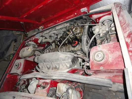

I have this idea of dropping a late 1980's Renault 5 super Diesel engine into an R4 (maybe F6) I would like to keep the R4 4 speed gearbox but i have reserved a 1982 R5 5 speed box locally if i need/want it.
What i want to know is, apart from the usual bracket making and cable ammending, how hard do you think it will be ????
Does the 1.7 GTD engine even turn the same way as an 1108 engine? Also the 1108 is an in line engine and the 1.7 GTD is transverse, will this cause any problems? what about with the gearbox?
I will probably have to make my own backplate for the bellhousing to attach to but thats easy. Will the R4 spigot shaft fit into the R5 crank (will probably use R5 flywheel)

That is a Mk2 Renault5 setup. It sits east-west in the engine bay. The R4 engine runs north -south. I cannot see an easy fix to your problem, butI can see why you would want to try.

This diesel engine has absolutely nothing in common with the GTL engine-even the petrol transverse engines which were essentially the same block, need too much work to be adapted to an R4.
So I don't think it's worth trying to install this particular engine on a 4. If you want to build a diesel R4 (interesting anyway) you could just start with any other (small) diesel engine and have to do the same, or even less, work.
