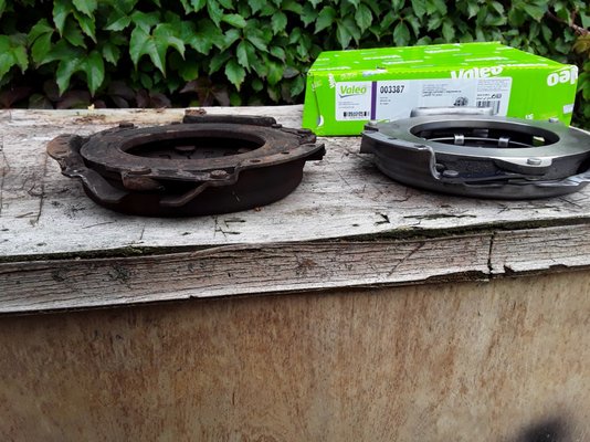

Just replace the clutchplates and pressure bearing only and do not replace the pressure group.
Nowadays the Valeo pressure group is constructed in a different way than the original ones.
On the new made pressure group the tangential leaf springs are contructed the other way round so forces are absorbed the other way around. Valeo has only looked at Cleon engine pressure group, the Billancourt engine pressure group has a different construction.
It will work but for how long....?
