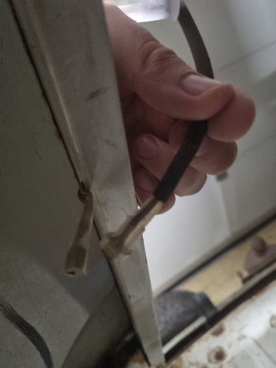

Thanks for the tip, your a super star!Remove the nut and the whole door should wiggle out sideways. Make sure the strut and wiring has been removed first.

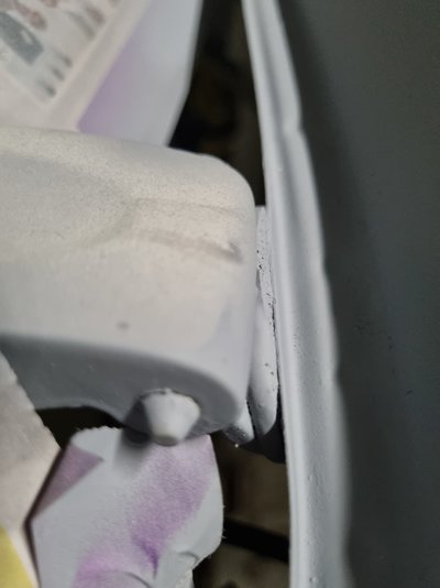

If you are painting it's neater to remove the hinges from the rear door after it has been removed. There are holes that allow access to the nuts.
