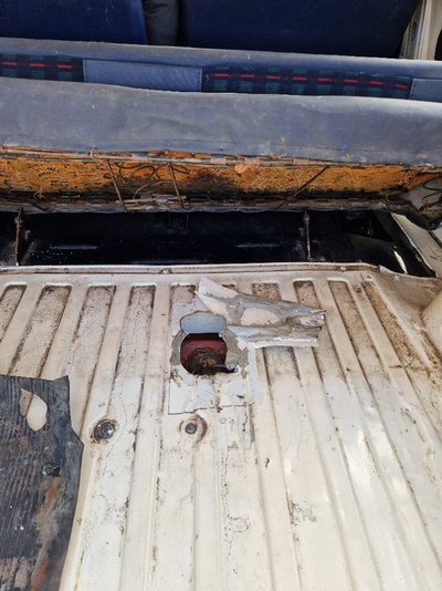

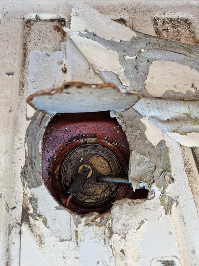

I started to investigate and found this. You had your problem here ?
Looks like Someone already had problem here and have cutted the floor...

I lowered the tank from under the car, but, having read your most recent post it seems someone's cut through the floor of the boot to access the sender unit, so you won't have to! Yes, this is where the problem was with the car I fixed. I bought a new sender unit from V.D.O.
Thanks for your help. Seems that sender unit is working fine. I will try to change just gasket and see will it help.
Looking at the photos with that hole in the trunk floor above the tank, wouldn't it be helpful to cut out a rectangular area with gasket and fit a lid with hinge and recessed lock? ;)
Was thinking the same.. a picture with a couple of dimensions on showing the centre of the Fuel sender location might be useful for somebody on here in the future :)
