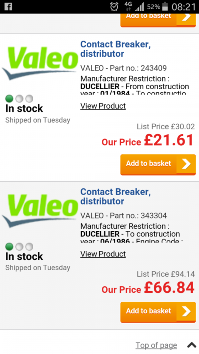

Mr auto does list valeo points btw screen shot from the app which links to website
Unfortunately no pics to confirm on listing

Interesting price on those points,mr reno they are about 7 euros here, but i think the lower one is possibly a complete dizzy as there are a few people selling them here for around about 100 euros.
First part number is a weird points set for a Marelli Distributor - I have never seen it on a R4.
Second part number is the normal GTL Ducellier points set without the tab for the spring as on Will's F4.
Prices are outrageous!
