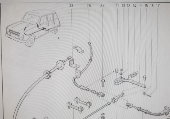

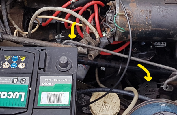

If the shoes are correctly adjusted, and the problem is that the handbrake lever (umbrella handle?) travels too far, there should be a way of compensating for play. I'm not sure what the exact arrangement is on the Spanish 4S, but on UK TLs (the handbrake operates on the front wheels) there are 2 points of adjustment - see photo:
If your handbrake operates on the rear wheels, there'll probably be a point of adjustment underneath the car - something like this:
It'd be interesting to see some more underbonnet photos of your car - and of the handbrake set-up!
