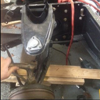

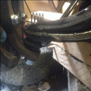

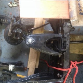

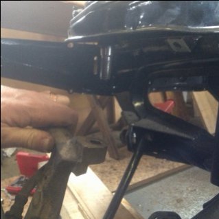

Hi All, Im a bit stuck. I cant get the shaft of the front top balljoint to line up with its corresponding hole in the hub. This is on a bare chassis so no engine up there but I had 4 bags of cement and 4 adult humans standing up front and car propped on its lower wishbones. This got the lower wishbone up. I got the shaft of the ball joint into the hole so that about 1 thread showed through the bottom but the angle is all wrong and I don't see it being able to keep going through due to the angle.
Do i just need more weight up there?
The lower wishbone and torsion bars were never removed so they are definately correct and Im pretty sure I have the upper wishbones on the correct sides
Any thoughts welcome.

They are definitly up side down.
I am on phone so can not post pictures.
But in my topic you can find how they should stay.
I have put jack under lower wishbone and rase it to connect with upper ball joint
