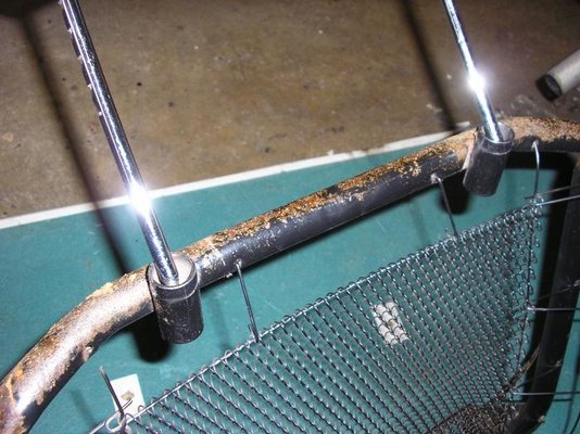

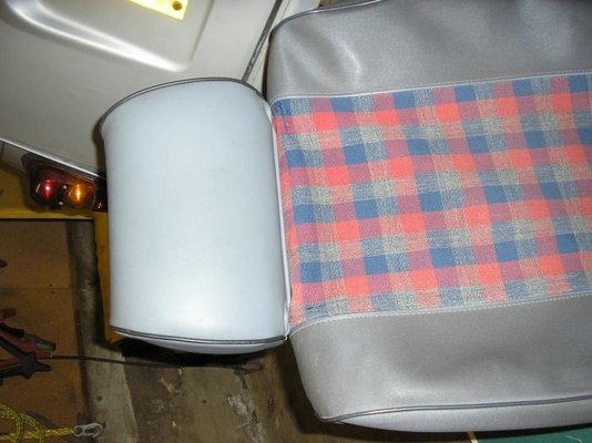

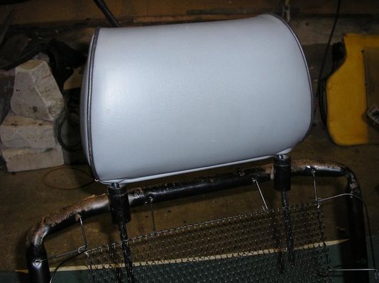

Try these... The colour of the headrest and seat is quite a close match. My seats are really dirty!
