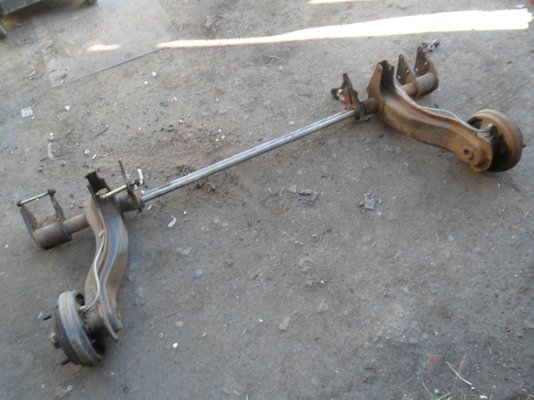

Hi guys, I can't be sure but I don't think that these pressed steel swinging arms will fit a later car. My 83 GTL has cast steel ones and there could well a difference in design of fit. Just a thought.

I would be interested alright provided it fits. Mine is a cast job, i wonder if that makes a difference

It should fit ok i have changed them before but to cast iron ones as they dont rust, I took this one of an 86 gt last week and the chassis mounting bolts are the same as the cast iron one,
this one is in good condition the torsion bars are rust free and there is still some paint left on the arms

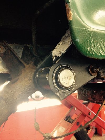

I'll tell you where we stand at the moment. The reason i'm looking for a rear axle is that my swing arm broke off just where it joins the outer bracket. I've done a little bit of work on a lathe and got a bar to fit into the swing arm at one end 22mm and into the bracket 23mm in diameter. I just have to weld it in place and see what happens. I don't know if this has been tried before or not. If this fails i'll take the axle off you. I will know either way by monday at the latest.

Thanks for the info, I have never heard of a break like that before i have seen torsion bars snap or the outer bracket rust out, Any way good luck with the repair

Was that a solid piece turned down to suit the new bush and then knocked into end of broken arm
That's it Paul. 32mm fits snug into the broken arm and 34mm into the bracket
