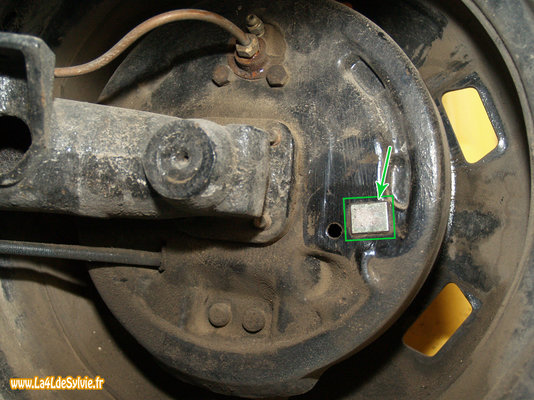

Paul, I do appreciate that someone like you will know in a flash what is there. You have the years of experience to back up that knowledge.
I read on la4desylvie.fr that if the "part" is square it is Bendix if circular it is Girling. Picture attached.
Is this sufficient to order from?

I have what my spare part dealer calls "moped brakes"
