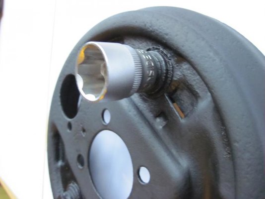

Can y rotate the shoe adjustement eccentric cams?
Mine wont rotate, i did put torch flame and rust off but no movement seen.
I see clarly that there is some kind of thin metal sheet between the eccentric disc and base metal but do not know what is it for?
I think i have to make a proper tool or purchase it somewhre, but the square nut did not move even i put it to jaw vice and tried to turn the whole backplate?:mad:

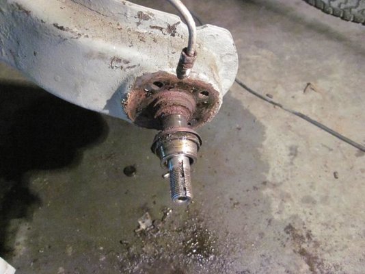

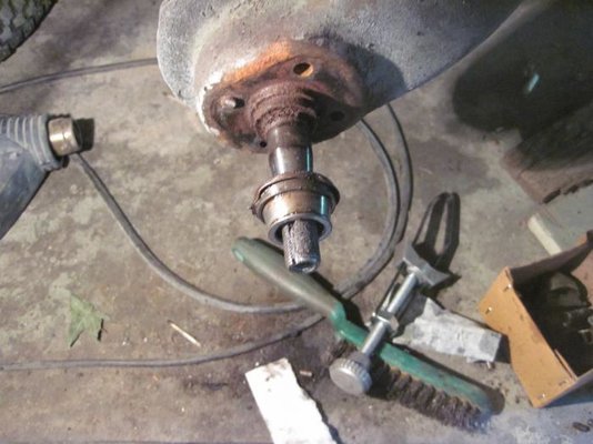

today i will pick up new rear bearings, i hope those will fit without any problems(i only wonder the inner bearings inner diameter, catalog gives 19,9 mm but i think my measurement was 21mm?-there should not be any such bearings in R4):confused:
rear wheel bearings
ah-did not get the bearings-instead it was bumber gum parts.

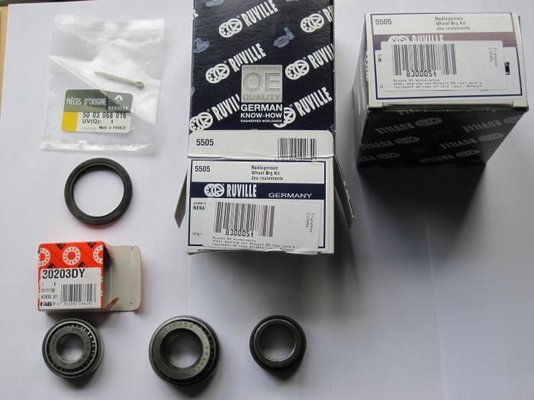

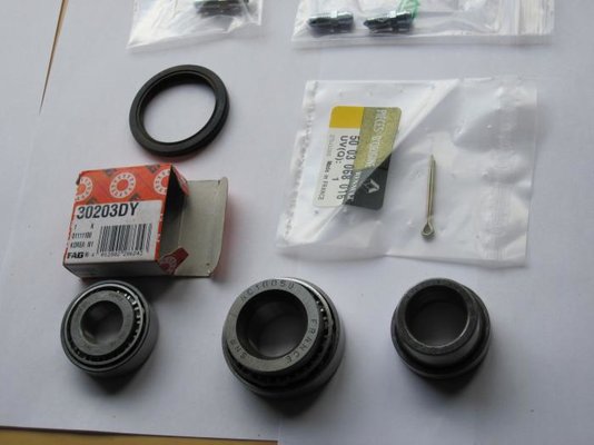

Took yesterday of, what was left off, inner rear wheel bearings, those seem to be brand SNR and type marking AC 10059
- d(shaft) is something like 22mm's and T(width) 22mm
anyone having the same?
where to byu new ones?
(equivalent brand and types should be A&S F15063 and IRB IR 2028/34, SNR AC-10059/32005)
(off-topic, Malcolm move it wherever you think it fits better)
We had discussed this with Geoff in the Gully recently, it's a special SNR bearing (you will notice the inside edge of the inner track has a radius not a right angle), 22 x 47 x 20,75mm. Try to search it at a bearing store near you with the SNR AC 10059 code. If you can't find it I can help you, I have found them here for about 35 euros each.
snr ac 10059
--luckily bearings received the rigth stuff-what i cannot undesrtand is sellers identification specs??
see the photos..and thanks

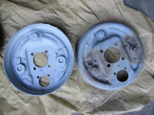

rear back plates revealed

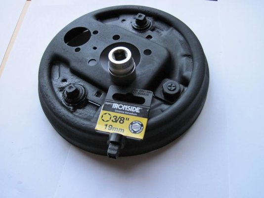

I got the adjusters rotating
when having no rigth tools i used the piece bougth backwards-it has a 100 rect hole which is ideal for the adjusters.
I did heat them up as much i could+then bang the adjuster bolt with hanmmer(on screw jaws under it+some oils-and it mowes!!)

as y see one bolt broken per each backplate
