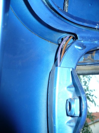

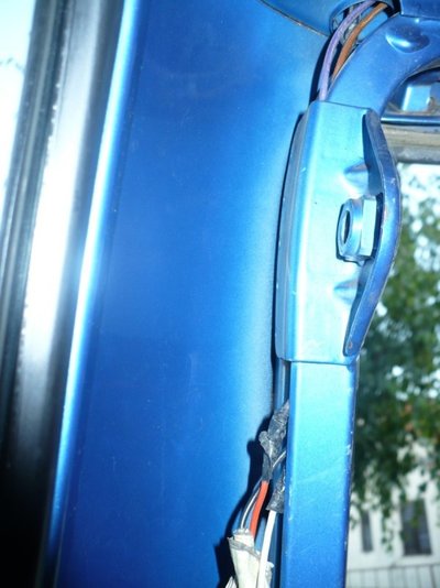

Can I ask you where do you plan to mount mechanism?
I am asking you that because on tail gate pillars upper corners there are mounting points for mechanism.
Here are pictures of mounting point on my R4 (picture show only upper right corner)

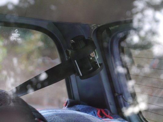

I've finally got round to mounting the Securon 254 in the rear of our Slovenian GTL. The inertia reel is mounted using the holes that petak has posted pictures of. The other end of the belt is bolted to the floor underneath the seats.
The 'sockets' (where the belt clips into) are bolted to the floor of the boot and come forwards between the seat and the seat back.
