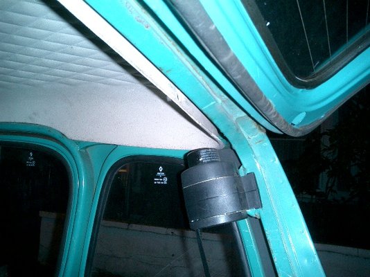

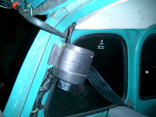

You need the securon seatbelts for the rear. They fit at a funny angle, and the securon ones are adjustable to make them work at that angle.
We fitted a set to Ian's car. The inertia reel was mounted at the attachments beside the top corners of the boot lid. I think I forgot to take photos but will have a look.

..Some photos..
..Here are some pics of my rear inertia seatbelts - They are at a funny angle as Malcolm said, but work fine..
