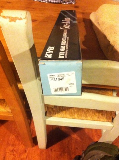

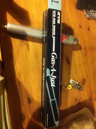

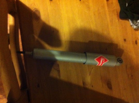

Hi image.jpgHi could image.jpg image.jpg image.jpg Hi could any body tell me if these would fit on my 1975 r4 tl,they measure from end to end 460mm I ordered them from a local parts firm ,according to the book they are the correct ones ,but my local mechanic saying they are to long ,can anybody help???
Thanks mark
Hello Mark. They look about the right length to me, and I'm sure that when I was playing around with my back suspension last year the measurement of 460 mm comes to mind, or there abouts. I was trying to raise the ride height at the time, but eventually I took my car to Derek Flavell of Renospeed who did the job, which involved removing the torsion bars. If you are simply replacing the shockers I'm pretty sure they should fit though. You need to take the weight of the car on the swinging arm, making the mounting points as far away from each other as possible. Sorry I have no record of the part number of the ones I fitted. Regards Brian.
I have exactly the same pair of shock absorbers on my 4L.
You have to fully compress them and hold there by some means, They are gas pressurised and will extend to full length by their own.
If you have a vice mounted on a solid heavy bench, put the end with the bolt eye in the vice and using some rags to cushion the other end give it some welly to compress it. Prior to this get some stout wire cut to length, two pieces required, and hook/twist them around each end. When you have the shocker compressed hook/twist the other two ends of wire together. This is really a two man job. Four Weetabix required for breakfast first. Good luck. Brian.

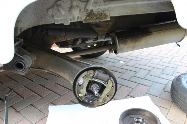

I simply couldn't get the eye end of the shock past the bracket on the swinging arm. even with the swinging arm jacked up as high as i could get it without damage ! the sachs bogel one that i removed had a much smaller eye knuckle and came out no problem ! The problem i found is that when i jacked the swinging arm up to increase the access the bracket was too close to the body underside to be able to get the new larger one in ! I would welcome any help regarding this also ? I attach a photo of my swinging arm to show the afore mentioned bracket
Hi Clanman, I can see how you had a problem fitting your shockers. The eye end is no bigger than 20mm thick on mine, and just bolts to the upright bracket on the outboard side. In your photo it looks like its bolted on the inboard side, I think this is wrong. Locate the stud on the other end first, but leave loose until you've sorted the eye end. Go on, you can do it. :)
