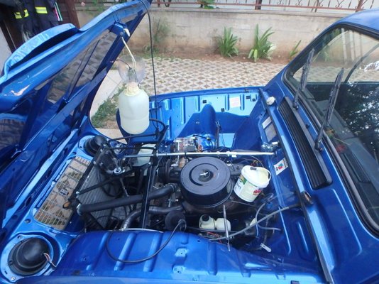

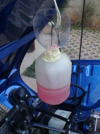

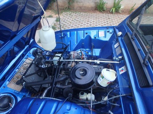

1.Lifted expansion bottle on top of the hood (opened - above bleeding screw), and opened bleeding screw on heater matrix at firewall (heating in side cabin turned to red - open valve).

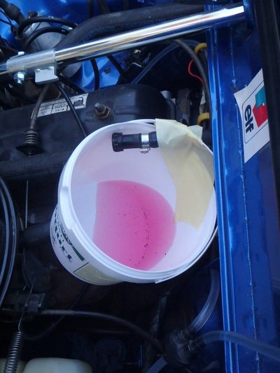

Set catching container at bleeding screw.
2 Slowly filled up antifreeze in bottle and left it to get into system. Opened cap on radiator to speed up filling system. Once cooling water get to top of that cap close it and left some more water to get in system
3. After a while on bleeding screw cooling water started to get out. left it to opened for some time more to get air out as much as possible. And then tighten bleeding screw.
That was it.
For whole process have prepared 5 liters of cooling water.
2 liters of antifreeze concentrate (- 80°C) and 3 liters of distilled water....end up with 5 liters of cooling water at -25°C. (according to recommendations on antifreeze bottle)
Quite enough for my part of Europe
Hope this will help to bleed your own R4 cooling system.

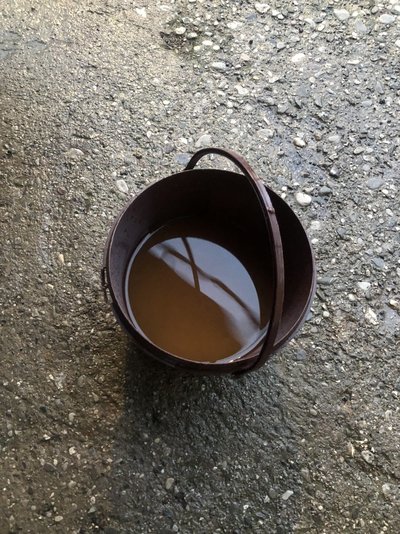

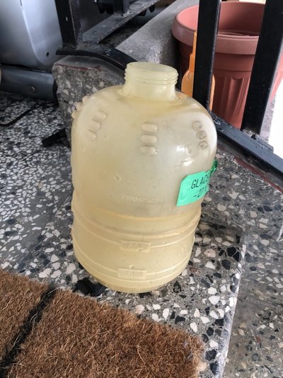

I detached the bottom radiator hose.. liquid was flowed out.. "liquid":
To be sure the cooling system is completely clean before adding fresh antifreeze, i use tablet for dish-washing machine.
When I filled the cooling system with only water to wash off the soap, only 3 liters of water has been added to the system (I expected 5 liters of cooling water.).
Heater control on HOT.
I fill the system with clean water and repeat this step, running the engine for around 20 mins.
There could be something wrong with the cooling system?

After a few days of driving the level dropped and in the end it was total poured 4 liters.
