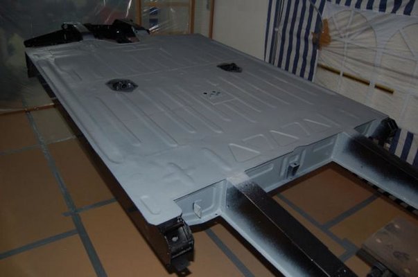

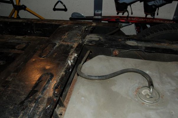

My GTL doesn't have a long bolt that goes all the way into the chassis, instead it's got a little bracket which holds one of those slide-on screwthread clips. You can see it in this picture:
attachment.php
You say you have a really old R4 so it might be different on those ones. But if not, than probably the thread of that clip has gone twisted and with some force you might be able to pull the bolt out or twist it out is you are able to find a way of both pulling it towards you and unscrew it at the same time.
If anyone gets what I mean ;).
You slide that clip on and that provides the thread into which that third bolt screws.
Y
Rutger! thanks a lot for the pic! it helps a lot to guess what it should have there, I will try your suggestion and then will post a picture of the result (probably a lot more rusty than yours!)
Thanks again!
It must be some clipped on square nut that came loose and is now free spinning.
It's pretty tight in there.
Here are 2 pictures of my 1985 F6.
Hope that helps (a bit)!
