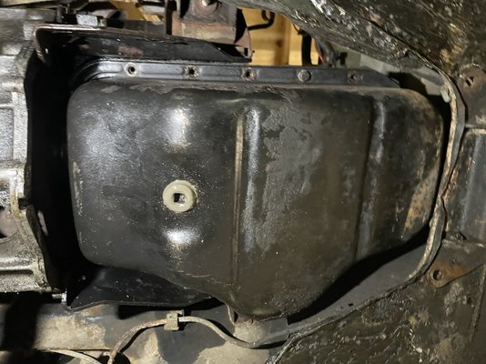

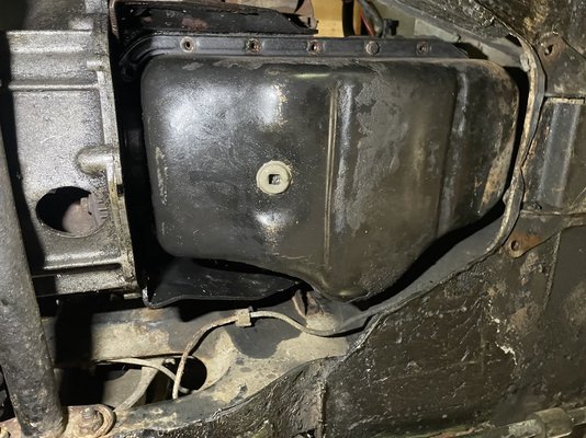

hello. i have low compression in no 1 cylinder. i have done the valves. still have low compression. goes up considerably when the cylinder has been given a few shirts of heavy oil. so convince that the problem is pistons or rings. i have been trying very hard to remove sump with engine in situ. i have at last managed to remove all fixings. the sump is loose, i am finding it impossible to remove as the bodywork gets in the way of the back of the sump. i am concluding that it is actually impossible. i therefore fear i will have to remove engine and gearbox. any views. is it actually possible or not? thanks michael

Thank you for this. i understand what you are saying but with the later engine this is not the problem.( the cross member) it is the back of the sump which is up behind the botton of the floor pan. i am trying to attach a photo. i think my only chance short of engine removal is the lift it slightly, say 2 inches the back to get enough clearance to drop the sump at an angle. it is the extreme right of the picture which is the problem. the haynes manual supplement helpfully just says 'drop the sump" and refers to the earlier section which is a for a different shape of sump which has its own different problems. if i can't do it then clearly i will have to take the engine out. it sounds like a lot of work, splitting drive shafts and moving steering racks.etc..

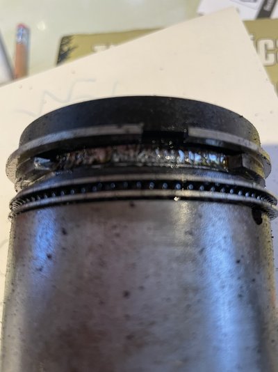

success. I have loosened the front engine(gearbox ) attachments but left in place. i have lifted the rear of the engine about 2 or 3 inches. this has not put strain on anything. i was then able to remove the sump and then conrod, take out piston and liner to discover a broken ring and a broken rim on the piston. many tahnks for comments.
here is what i took out. apart from this piston everything else looks good, bores as new and shell is good. can anyone help me with how to get one piston and rings? 70mm or to fit bore of 70mm.
