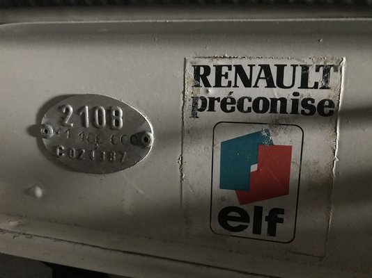

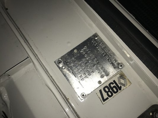

I have just bought a F4 and need to find out the engine size and confirm the year of manufacture.
The square plate is stamped - VF4 21060000503072
The oval plate 2106 / 41 100 050 / J020010 / 031
Can someone decipher this please.
Regards
Martin
Regards
Martin
Strange VIN for a R4F4. The W.M.I. first 3 digits VF4 is the Talbot Brand
For R4's manufactured in Europe France the first 3 must be VF1 maybe a typo?
Check the VIN that is stamped in the chassis
Regards
Martin

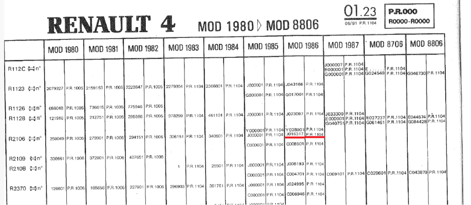

I think it's a late 1986 manufactured car, looking at P.R.1104 the R2106 starts at J016317 in 1986 and is discontinued in 1987.
