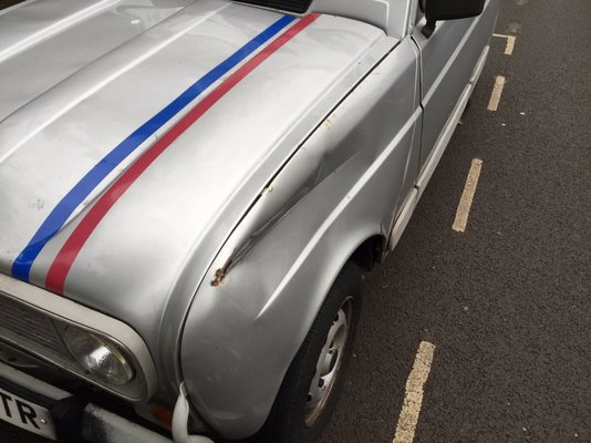

I’ve only had this since April and done just over a thousand miles and runs great. There is a dent, however, on the offside wing where some idiot reversed into it parked down my road.. i’ve tried to show it in the pictures. Front two seat covers are a bit ripped but I believe you can replace them fairly cheaply, the back seats are fine.

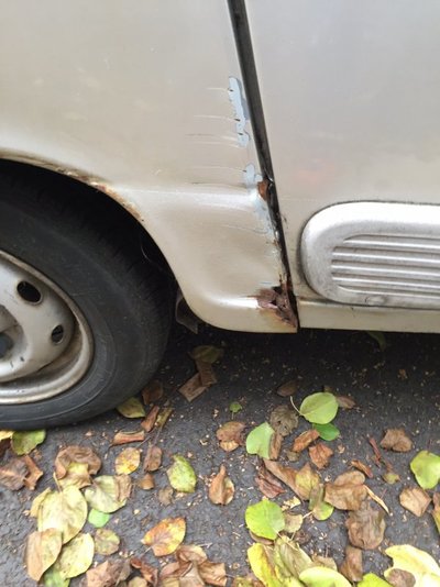

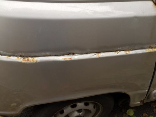

Hi OJ, as a matter of interest where exactly does it need welding? I only see what looks like surface rust apart from the small hole at the bottom of the rear wing.

There's plenty of areas which can have holes but not ACTUALLY FAILABLE
second opinion worth seeking as even if you spend money now unless all rust is cut out and treated it will only be short term repair
