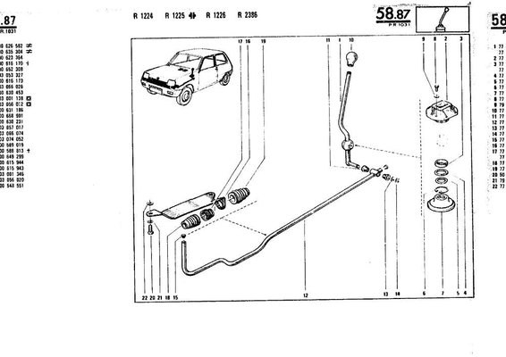

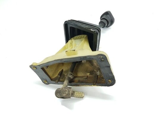

Okay, I haven't had chance to look at the van but I did find an eBay listing with a picture of the gear linkage I've got and that helps me understand things a bit better.
I'm wondering if this is the same as is used in the early Clio, it looks very similar. Does that help at all with diagnosis of what I should be looking for? Also, the gear knob spins freely but doesn't seem to unscrew or want to readily pop off, could this be related to the issue?
Check also the linkage at the gearbox end of the lever. There used to be a service kit available with all the plastic bushes, washers etc.
The connection between the gearshift lever (the part in your picture) and the lever rod that goes to the gearbox is held by a collar and is adjustable both fore and aft, and sideways. It is possible that this collar has worked loose (or mis-adjusted at some point) and lost its position. There is a detailed procedure in the workshop manual on how to adjust it.
