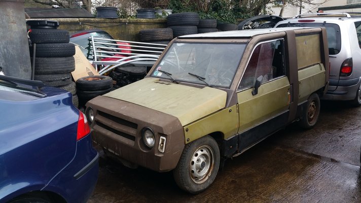

Pic of one of mine other has been dismantled FB_IMG_1423922748871.jpglink to my project here

Pic of one of mine other has been dismantled View attachment 16165link to my project here
