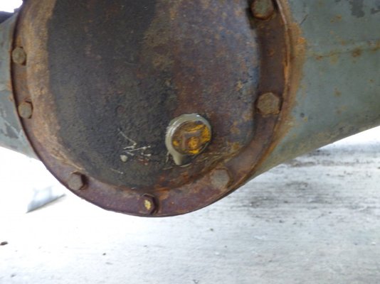

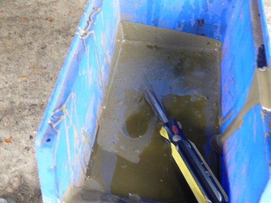

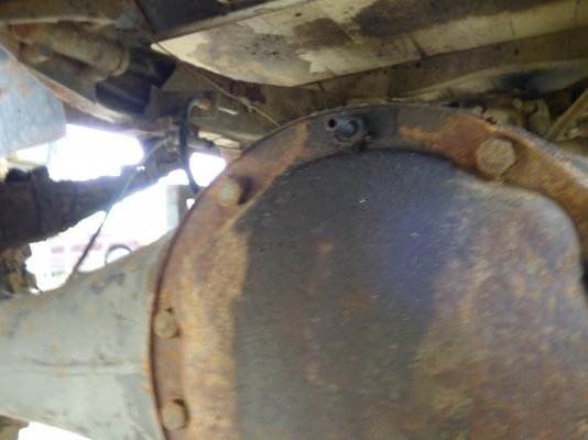

Pictures of axle oil problem asked for by R2087.
Is the plug shown the oil level plug.
Cannot see a drain plug
l assume the tube at the top is a breather...the front axle seems to have a slotted screw.

Bonjour R2087
At first the computer could translate...but not anymore...probably down to me.
Not to worry, have achieved change of oils...but a bad leak from the front seal of the transfer box has been discovered...need to get a seal.
Le Hulk starts instantly now and runs smooth. Greased all the nipples except 2 rear ball joints on the steering....just cannot get any grease through.
Handbrake cables greased up and operate smoothly....unseized the clevis pins also along with the large lever assembly for the transfer box.
Installed a 24 Volt alternator from a DAF but having a spot of trouble with wiring....ammeter not registering and warning light not extinguishing...mmmh.
Funnily l discovered the coil is 12 Volt and the feed runs from just one battery(rear one).
More to do before confident for longer journeys.
l'd better dismantle the front housing of the transfer box tomorrow morning.

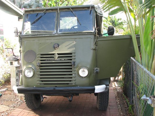

Just got the 2067 Torpedo on the road, though without turn sig pots. Located in Florida. Some say it is the only one in USA. True? Brought it in from France last Dec. Painful and expensive. 45078 km Countless small and large projects done.
Ideas on the wheelwells in the bed...wheel travel cannot possibly enter the wells. How about removing them? I plan to do so. They are badly dented and useless except for sitting.
Found original tag numbers under layers of paint. Corresponds to research for 1950s Gendarmerie. I have made all markings (self-adhesive) and will apply them Last Thing.
Also need to know what spotlight was used on Gendarmerie vehicles. I am assembling a correct uniform for Algeria 1956.
Also what is small bracket drivers side on corner bottom of cast windshield frame?
Also why 2 tapped holes in drivers side upper hinge?

To John Kessler : if you could provide pictures of the parts you have questions about (wheelwells and last two points), it would be helpful, not sure of what you meant, if you also come back on the R2087 forum, we could maybe help there

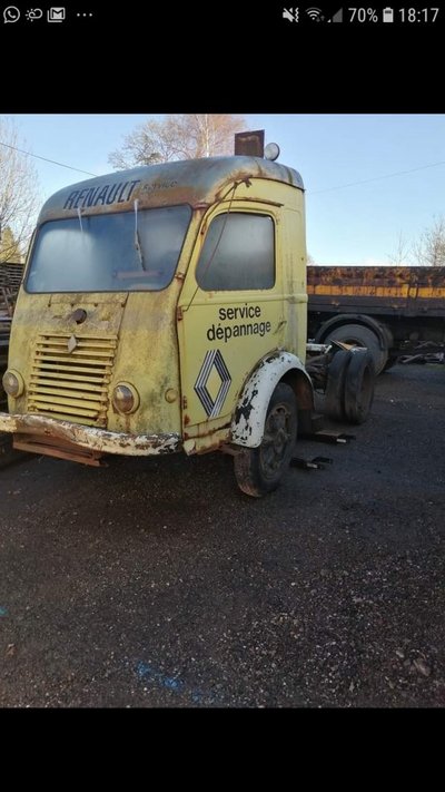

Hi,
I have been watching this on Facebook. Is it a Goelette? It has a seized engine so may well need a replacement. Not a lot of spare parts seem to exist in the UK. Are replacement engines available in France?
