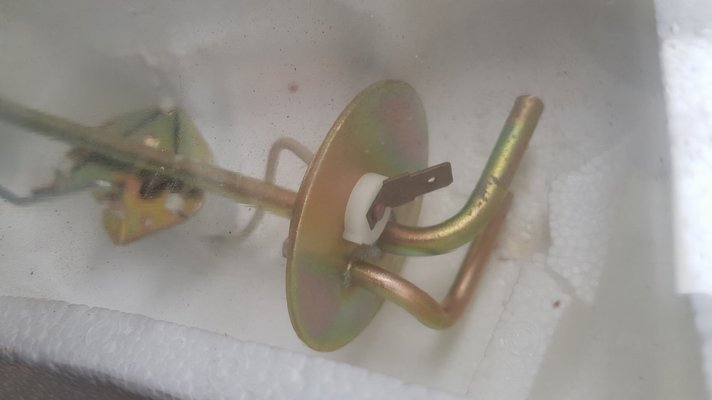

I am ordering a new tank and sender but have hit another problem. The original sender is a bayonet type with 2 pipes exiting the top. One is the fuel line and the other connects to a fuel return pipe on the car with the interior end of the pipe just entering the tank. All the senders for sale have only 1 pipe (the fuel line). So I am stumped as to why my car (1987 GTL) has a return pipe when all the mechanics I talk to say the senders only ever had 1 pipe. My question is what will happen if I just blank off the return pipe and ignore fuel will not return to the tank. Any advice gratefully received.

Presumably your fuel pump is the 3-pipe type; I imagine the system with the return pipe was introduced to help combat problems with vapour lock. I remember that some of the later Mk 1 Renault 5s had a sender with a return (see photo below).
