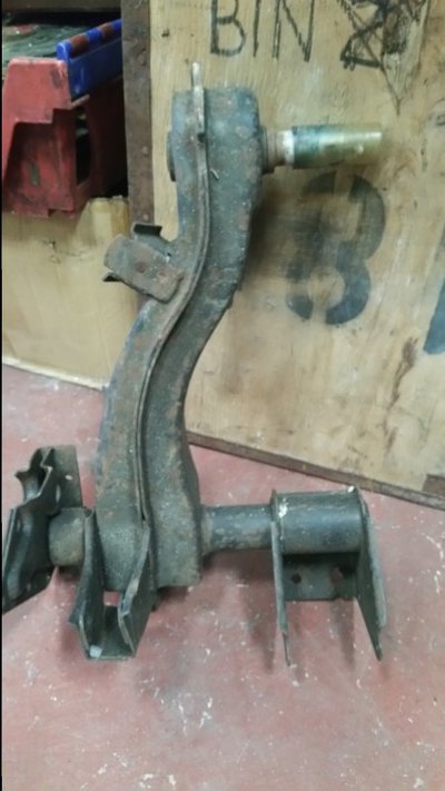

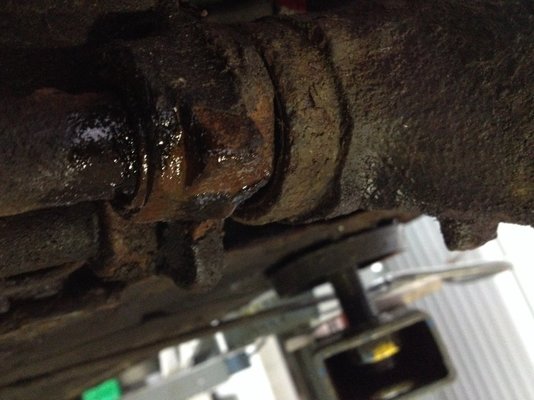

After some hours work I was finally ready to put the torsion bars back in place. when I was adjusting the hight of the right wheelarm a sudden cracking noise found my ear. The wheelarm had sheared of completely inside the outer silentbloc.

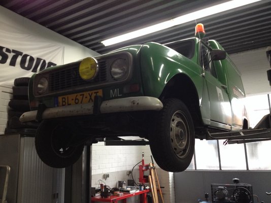

So yesterday I replaced the lot with an old TL Rear axle until I find a new right wheelarm.
my poor forester whithout its rear axle

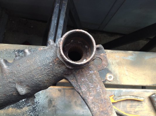

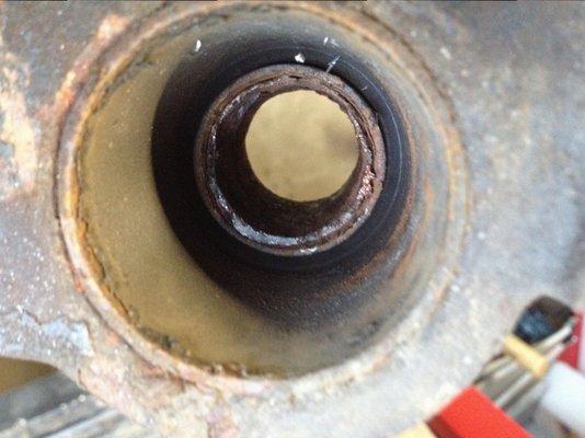

broken inner silent block it turned out that the inner steel bushing had perished the rubber was fine

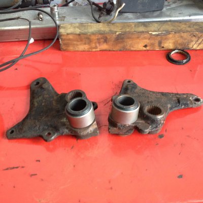

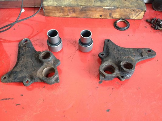

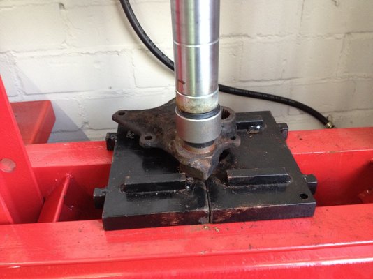

New inner silentblocs and the anchor plates

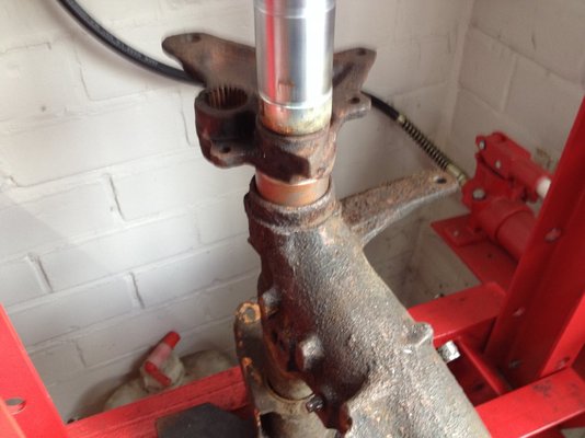

pushing in place

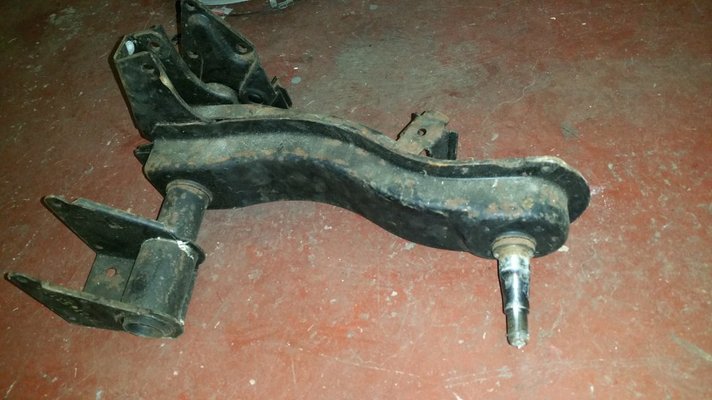

cleaned up wheelarm

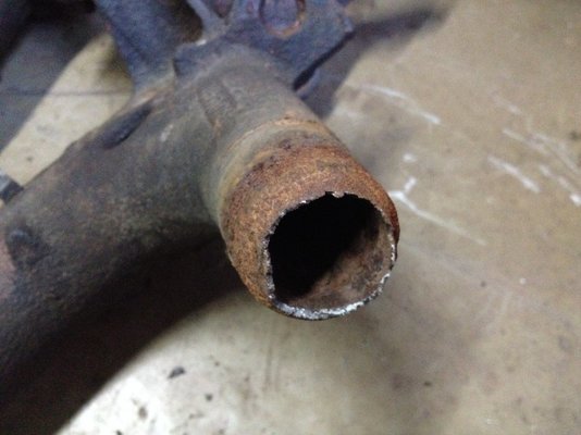

This is what 30+ years of water salt and grime does to unprotected steal. Adjusting the wheel hight finishes it.
pushing in place
cleaned up wheelarm
