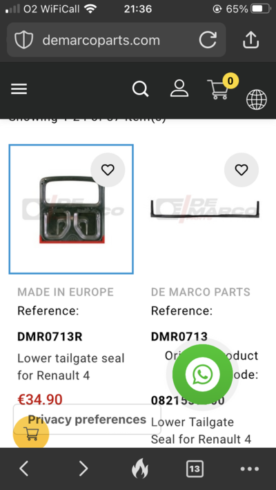

Bought a part which IMG_6087.pngbought this part but having some issues to fit, checking we have the right part and some guidance, tips on fitting.
Hi
It is the right part but some aftermarket seals are shaped slightly different to the original and can be of different thicknesses to the original. I personally have not fitted the De Marco seal but have fitted the Der Franzose seal which even though made the tailgate sit a bit proud to start with (I could still shut it). I have noticed over time as the seal has settled and compacted, the tailgate sits less proud. My glue of choice is Evostik as it is a forgiving glue. If you go wrong (you can rub it off the paint when dry without damaging the paint and can remove the seal for a second attempt if necessary without taking chunks of rubber out of the seal. Apply glue to both surfaces, allow for glue to become tacky, offer up the seal, secure with masking tape, shut the tailgate, leave overnight to fully adhere, then good to go.
