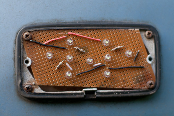

Both my reversing lights were completely rusted away inside so I stripped them out and made new circuits with bright white LEDs. I have hundreds of leftover LEDs and other circuit bits, so I could make more and they'd cost a lot less than 28€.
Also my gearbox switch is kaput, tested by bypassing it with a bit of wire. I've just bought a new one (CI brand, came with a handy aluminium washer too) so I'll fit it tonight and upload photos of my new lights when they're working. I'm quite proud of them :)

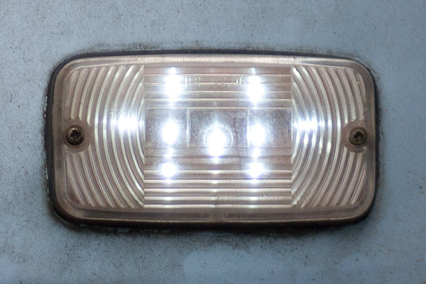

Here's my lights. They're quite nice, though I'm thinking of adding more LEDs because they could be brighter.
Combined reversing and fog lamps is a good idea, and should be very easy to do. There is plenty of room on the board. I might try it, as I have about a hundred red LEDs lying around :)
