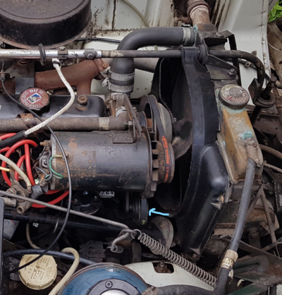

Another thought - could your belt tensioner bearing be on the way out?
Might be the case. I've given all belt pulleys some grease to see if it eases off.
There's norhing to be heard now, so all is well. The 4 will be home from the welder on friday or monday, and fit for a few years more of duty before a complete overhaull.
