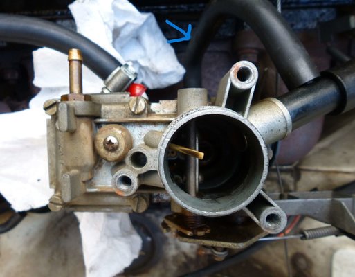

Hi Adam
The pipe that goes to the manifold (under the carb; engine side) hasn't fallen off, has it?
I've changed the plugs, the distributor cap, ignition coil, air filter and a new set of HT leads are on their way. I did mess about with the current HT leads, one wasn't conducting very well. Gave it a clean and got a decent resistance out of it.
It might be worth changing the condenser as well.
