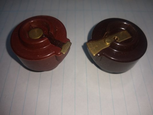

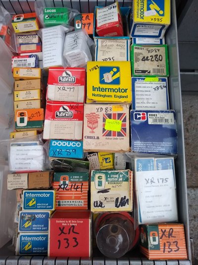

If you can provide a photo of your rotor arm Trish, I'm sure someone will be able to identify it. I've got a lot of rotor arms, (& caps, points & condensers) for classic French cars, including several listed for R4:

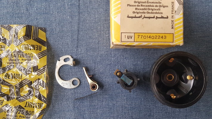

Thanks everyone! I just love the kindness and the friendly advice. We discovered the part number for the rotor
arm and found it on eBay. My daughter is seeing to buying one or maybe four! It's a bit complicated

In case it helps someone else looking for a rotor arm for a 1123 Ducellier distributor, what's the part number you found for your rotor arm?
The carbon brush is not available separately, you have to get the distributor cap.
