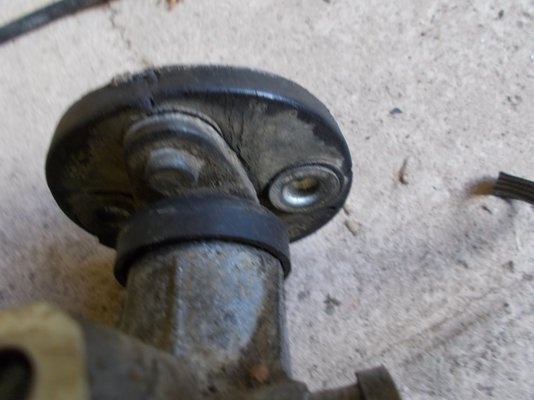

Rubber disc on steering pinion
Johnny
26
Taunton
Is anyone able to tell me how to remove the two "pins" that attach the rubber disc that is between the bottom of the steering shaft and the pinion in the steering rack please? The disc is splitting and needs to be replaced. I hope that I have attached a picture showing the underside of the disc and pins. All help gratefully received!
Johnny
An angle grinder with a 1mm disc wil do it for you.
Replace with M8 bolts and nylock nuts
