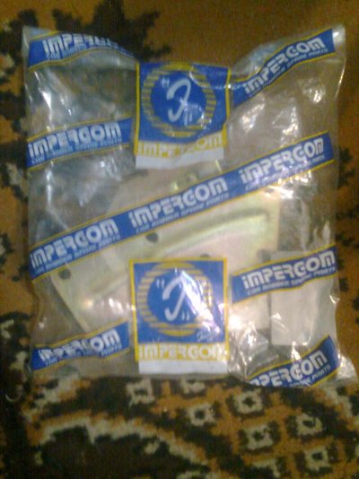

So, about the new mount, it's make is IMPERGOM, made in italy (torino), impergom part no: 29470/1 ! I've got it for 27.5 Euro :D Hope this will have a long life :D
Ps: this was the only thing available ! The quality is a medium one :D
