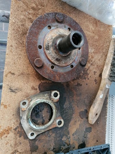

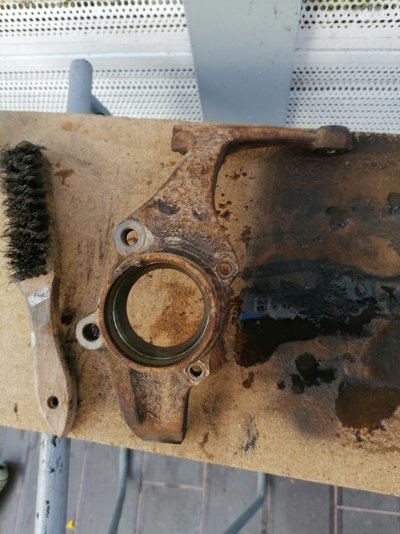

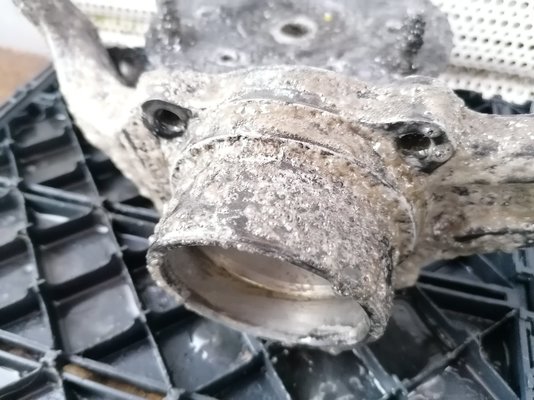

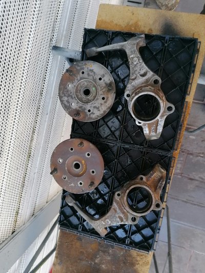

After a lot of work, ainda steel have rust.. Continue tomorrow
Before
Ready for tomorrow..

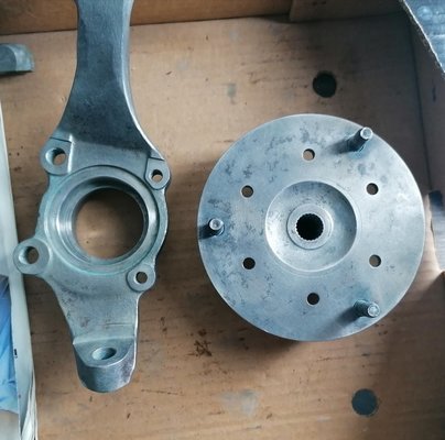

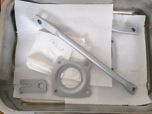

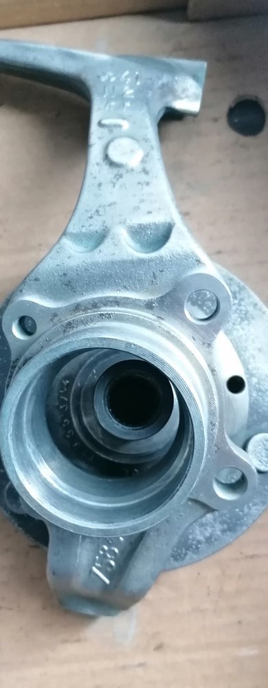

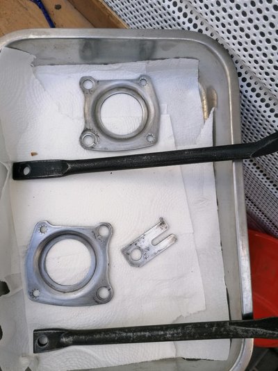

Today was another day around the rust.. Cleaned the remover with hot water and a wire brush, but was not good yet.. So more sanding.. And another night with the remover
The small pieces are good
Before
During
