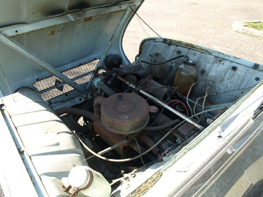

Now that I have introduced you to Mildred, I need some advice on the scary part of the car - the engine.
She hasn't run for at least 10 years and I don't know what state the engine was in when she came off the road. The owner of the last couple of years poured diesel into the spark plug ports (presumably to help free everything up.) The oil smells horrible (of fuel) and peering through the oil filer, it looks horrid, dry and sludgy in there :eek:
My friends and I would like to see if this engine will run, but we are concerned. Having stood for so long and with the oil in such a horrid state, we were wondering if we should flush something through to try and clean out the gunk? Is this wise?

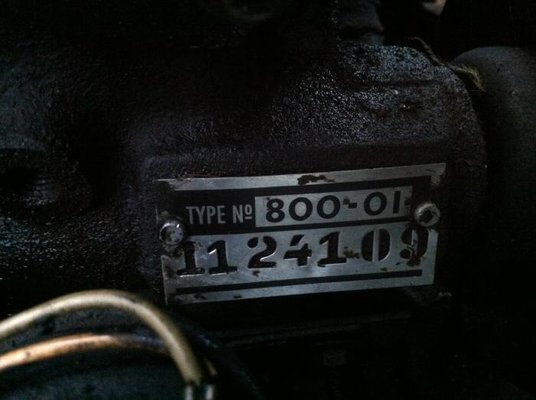

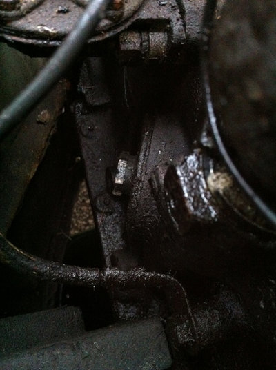

Also, the oil filter is absent. There is a strange cap in place of it (see picture.) I have never seen anything like this before. I know early 4's didn't have an oil filter, but surely this one should? I don't know what this is... Can anyone shed any light on this?

Hi Chris. Presumably the engine turns over. The first thing I would do is drain the sump and refill with nice new oil. Then remove the spark plugs and disconnect the fuel line and let that run into a suitable receptacle just in case there is any fuel in the tank. Then i would just bite the bullet and see if it turns over on the starter, just a short burst will do. I'm not sure about this filter blank, I guess loads of folks out there in 4L land will be able to advise you, but I suppose it must have run with this in place. If you are feeling brave reconnect everything up and see if it will start. Perhaps drain the oil after a while and refill with new. Very good luck, Brian.
I should have also said, put some new fuel in the tank. Brian.
Filter blank is normal - it just means the original owner saved money by not getting an oil filter (I advise more frequent changes -although the little 845 takes very little)

It should be possible to get an oil filter adaptor, which is a threaded pipe which you screw into the socket where the filter blank is mounted and then you can put an ordinary oil filter on the front. In fact, if you find a later 845cc scrap engine you can simply unscrew this pipe (careful not to damage the threads) for use in your own vehicle.

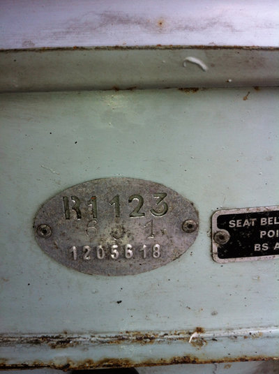

I did this for my 1972 R4 which has an oval plate number close to yours (1211348). The pipe is a bona-fide R4 spare whose part number was (in 1992) 77 00 532 934. For the type 800 engine it should be 19mm thread diameter throughout (later ones have 19 on one end and 20 on the other)

Only thing I would add is if the engine has suffered badly from lack of oil changes and then been left sitting it might well need a rebuild. The R5 of mine had completely gummed up piston rings.
Risk of starting it is it's possible to make any damage worse, though if the engine turns I'd probably take the risk myself.
Changing the oil, removing the plugs, then turning the engine over on the starter or crank handle for some time will hopefully get fresh oil around the bearings.
Then go around cleaning points, checking spark etc and new fuel from a suitable container (I use an old radiator expansion bottle) to feed the carb.
If you get it going keep an eye on the cooling and make sure the radiator heats up - thermostats can seize shut.
Last one I started up was an old Renault 5 that had been sitting outside for 10 years. That needed petrol dropping into the carburettor to start it as the valves had stuck open and there was little compression. It doesn't run well - needs a rebuild
