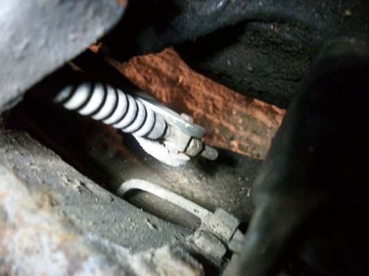

Hi Azazello I have some photos for you. I now know why I was lying underneath the car when I adjusted the clutch. It's because the starter motor is in the way. Lying under the car there is a small gap between the sump and the chassis. It's difficult but possible to work from there.
You have to be careful not to turn the nut too much (if it is seized or rusty)because the threaded bar is attached to the clutch cable.
First photo is looking from the top with the starter motor removed The bracket is bolted to the engine mount

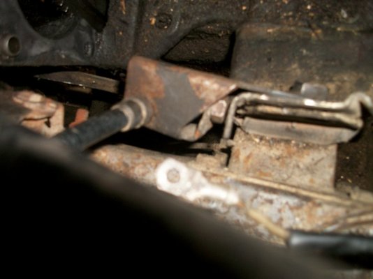

The next photo the bracket is moved (the bracket has a slot in it where the cable slides in) and you can see the clutch cable going into the clutch lever arm

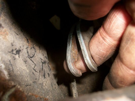

In the next photo you can see the clutch lever end. It has a cut out underneath where the end cross pin from the cable fits. The cut outs are where my fingers are

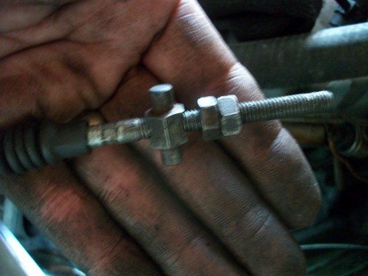

In the last photo is the cable end. To release the cable, I pulled the clutch lever upwards and pushed the cable end downwards. It came out quite easily. The bottom nut is only to secure the top nut after adjustment.
I don't think it will help you with the scratching noise but it will definitely make gear changing a bit easier.I think it is possible to remove the cable and work from above
