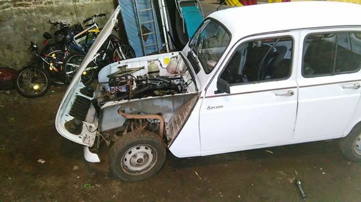

D Dyte Enthusiast Messages 8 Location France Nov 8, 2015 #1 Hi,all what type of sealer should I use when refitting the front wings ? Thanks in advance
malcolm & Clementine the Cat Messages 4,600 Location Bedford UK Nov 9, 2015 #2 Polyurethane sealant is the stuff to use. Here is a page about my seam sealing - http://www.renault4.co.uk/gordini-sealant.htm
D Dyte Enthusiast Messages 8 Location France Nov 9, 2015 #3 All done I used 3m pu seam sealer 20151109_102221.jpg 128.5 KB · Views: 1
