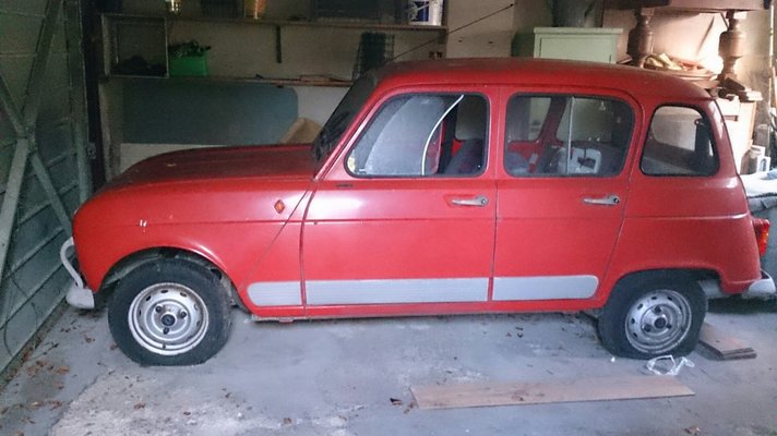

Seized 4 GTL Engine.
John Alliott
2
TORQUAY
My 1985 Renault 4 GTL has been dry stored since 1995 in Guernsey. The Renault dealer there has recently recovered the car and advised me that the engine was seized. But after using a spray-on loosener, WD 40 I imagine, they managed to free the engine manually and now it can be be turned by hand.
They are reluctant to try and start the car in case further damage is caused.
Does anyone think, as I do, that it would be OK to start the engine anyway, since the alternative is a complete engine rebuild?
The car has only covered 56k miles.
Any comments gratefully received.
Many thanks.
