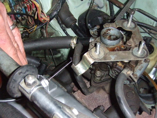

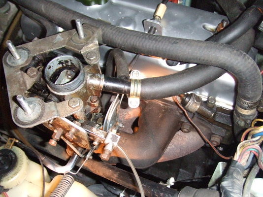

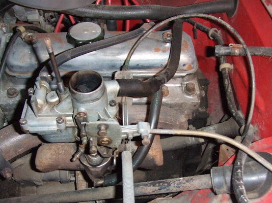

I wanted to attach some photos with a PM that I sent to someone, but couldn't work out how to do it. Is it at all possible?
Anyway, I'm posting the photos on this thread. My 850 and 1100 have the same Zenith carb. The rocker cover breather tube is connected to the carb differently.
The red 850 goes directly but the 1100 has a breather tube on the side of the oil dipstick.and a rubber tube goes from there all the way to the carb with the rocker cover breather tube joining half way with a "T" connector.

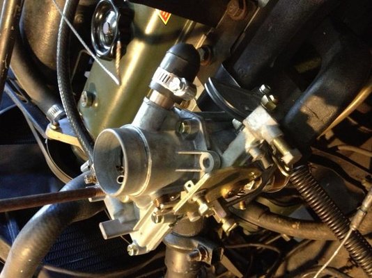

Hi Mojo thanks for information, I have gone for plug option on the carby, started it up and it was a completely different engine! The solex I replaced was definitely in a sad state.
