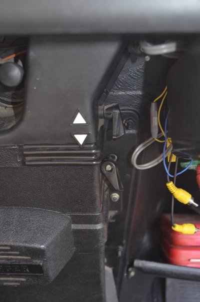

took him out for a drive ,window was very steamed up put fan blower on and turned a little knob under gear stick ,had some white smoke coming from under bonnet on drivers side ,turned blower off no more smoke,under gear stick there is two black knobs look like they turn up and down and two white arrows ,can someone help me Renault 4tl thankyou

any help on what those button do cant find any info ,online two white arrows under gear stick one up one down,on side of that on passenger side two black knobs like triangle shape that seem too turn up and down,? will have a look under bonnet tom ,which one is accelerator cable,complete novice when it comes to car engines can get someone else to sit in it and rev why I look tom ,sounded a bit clunky after had fan blower on front wind screen when I came to a stop ,like a clicking sound but stopped when engine stopped and didn't happen when I re started it? thankyou for reply

The arrows are for hot and cold ,up for hot down for cold,one of the levers controls the fresh air vent and the other one directs the air to demist or down for cabin. The reason for the left hand wing being hot is that the exhaust is underneath.Check your expansion tank coolant level if the gauge registers a high reading, hope this helps.

Chris - get under the bonnet and just look - find the bottle (normally a cloudy orange) it will be connected via a small tube tot he tope of the radiator. There are two larger tubes top and bottom of the radiator. These go into the engine (water pump). From the same area (water pump) there are two smaller tubes going to the bulkhead (under windscreen). These two smaller tubes are the heater circuit and they go into the car into a much smaller radiator (the heater). This is the small black knob that goes up or down and controls a small valve (tap) that closes the water going into the heater radiator (heater matrix). When you open it to hot the water will flow.
